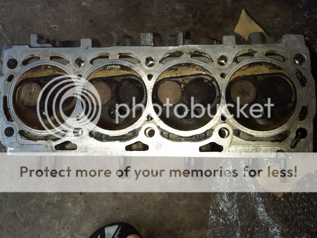

Are you sure, that this engine has 8 valves?
I found only the 1.6 engine with 16valves and 105hp.

ye positive it is 8v - it is in my car :haha:

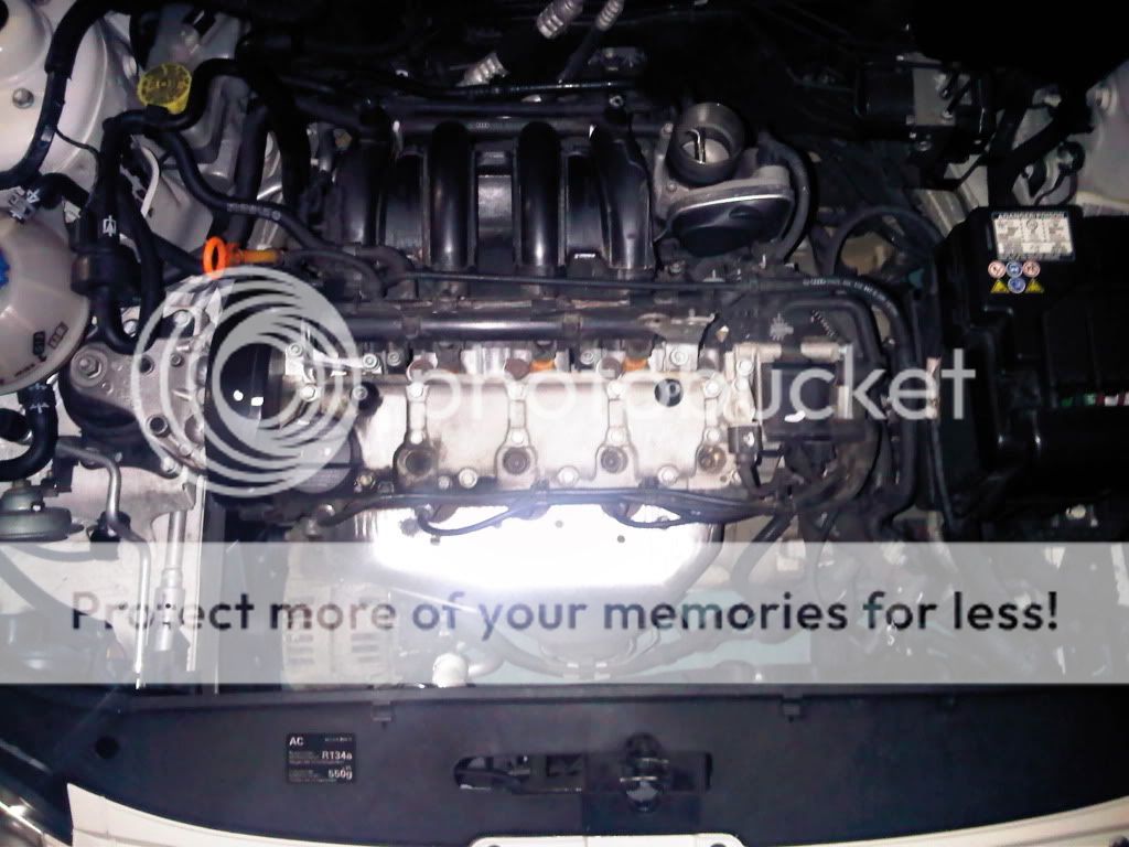

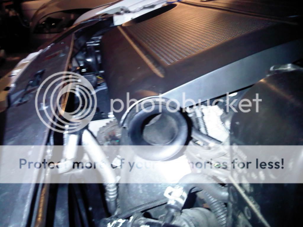

The SR engine looks different! my car, the engine cover is also the airbox

I think the Golf V ( + Touran / Caddy) has also this engine:
http://www.doppel-wobber.de/wbb2/Inform ... toren.html
The engine is not used for Polos in Europe, there an engine with 16 valves is used ('BTS'), also based on the EA111 block, but with a timing chain and single ignition coils
