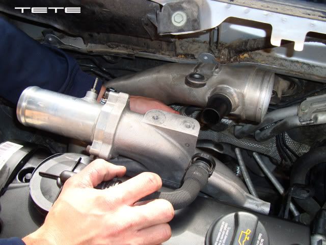

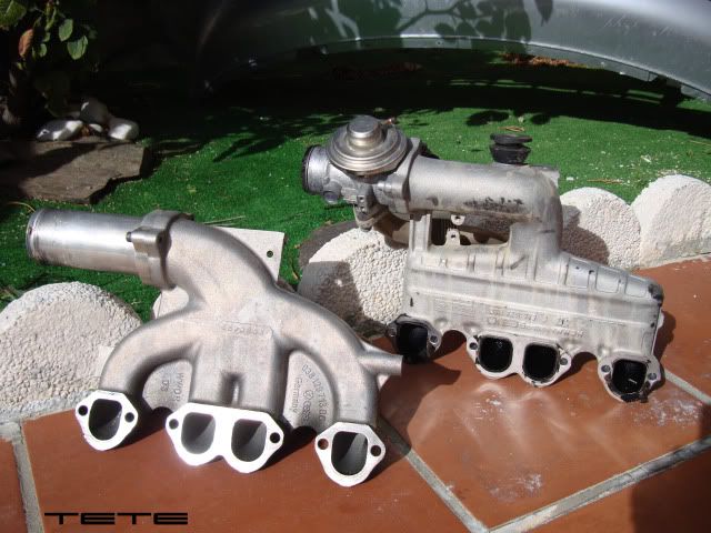

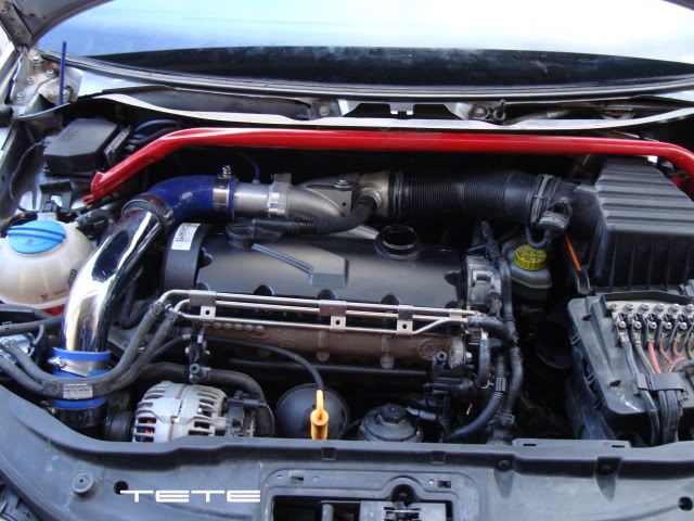

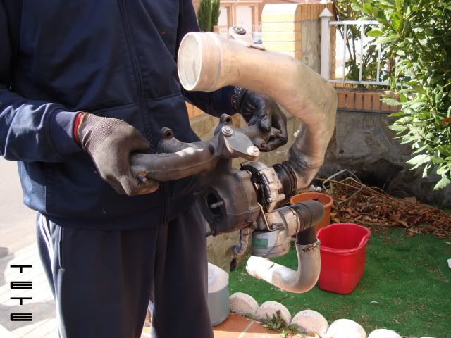

In November and mount 1749vb Ibiza Cupra tdi
We started to dismantle the whole, turbo, manifold, etc and getting the oil ...
Here the whole arsenal that we had to ride.
With original boards, all new!
Once removed everything from series of 100, compared with the new things that would fall to the Pole ...
Ths-Performance Downpipe
-Inletpipe
-Intake manifold 150/160 + suppressor Egr
-Turbo 1749vb with pipes mounted Limpita
And to ride it all ...
And finally ... So too does the conversion
Greetings! :-D

Looks great! :cheesy: I wait for a Video, and the good Spain Weather! :hmhm:

very nice!
9n cup front of the blue polo is :top:
